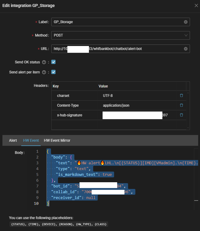

But the HW Event target of the Integration is broken. As the image shows, the Integration does not work with HW events. Cannot save configuration when Alert metric is turned on and off.

we do not really get it, is that about disappearing assigned integrations when you disable the item?
Its disappearing when disabled, and HW events Alert not working with Integration. I think its cannot save setting.

can you send us screenshot of your settings of custom integration?
There are different tabs for JSON bodies for performance and HW alerts.
Performance Alert working good with same integrations endpoint, same setting.
My settings of custom integration:
Alert tab
"body": {
"text": "🔥Monitor alert🔥LHL.\n{SUBSYSTEM} [{LEVEL}][IMD][admin].\n{TIME}.\n{ALERT_NAME}, {METRIC}, Limit: >= {LIMIT}.\n{ITEMS_WITH_VALUES}.\nSite [{PARENTS}]",
"type": "text",
"is_markdown_text": true
"bot_id": "1234",
"collab_id": "4321",
"receiver_id": null
HW event tab
"body": {
"text": "🔥HW alert🔥LHL.\n[{STATUS}][IMD][admin].\n{TIME}.\n{DEVICE}.\n{REASON}.\n{HW_TYPE}, {CLASS}",
"type": "text",
"bot_id": "1234",
"receiver_id": null
