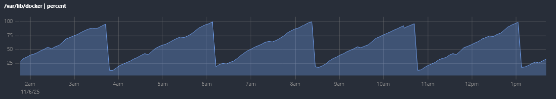

In this chart you can see that every 2h more or less it gets full and cleans itself:

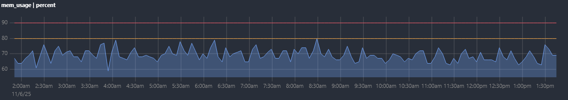

For some reason is not using all the memory the OS has available and then it writes query temp files to disk:
Any idea how to fix it?

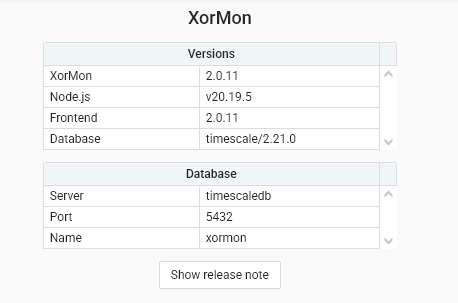

Versions used:
we've encountered this issue before. TimescaleDB versions 2.21.x are broken. It would be best to upgrade to the latest timescaledb docker version(as of now 2.23.0).
