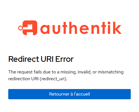

Unfortunately, I can't get it to work, I will always get a popup with the error:
And this, despite I have the redirect URL configured to a regex https://xormon.mydomain/api/oidc/v1/*

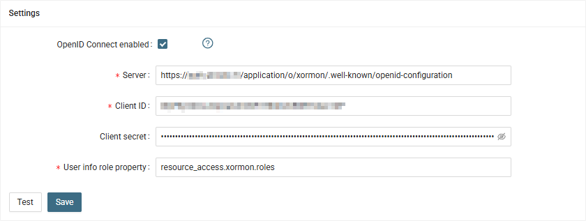

I share my Xormon SSO configuration just in case:

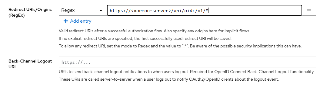

I've just tested Authentik and it works. Are you setting the redirect URLs correctly?
Strange, this is what I have in my redirect URL(s):
Of course, <xormon-server> was replaced by my external Xormon URL! 😊
And I also tried this as in documentation (of course with my domain):
https://<xormon-server>/api/oidc/v1/roles for test and https://<xormon-server>/api/oidc/v1/login for login
I didn't put the redirect URL straight away, so I'll rebuild it from scratch to be sure.
for regex try /.* instead of just /* wildcard

When you see the redirect URI error in new window, what is the redirect URL in address bar? Is it same as entered in Authentik?
Nope, I see that (replaced values with X) : https://auth.myexternal.domain/application/o/authorize/?redirect_uri=https%3A%2F%2F192.168.X.Y
So it takes my Xormon macvlan IP address on local network and I would say"of course" it doesn't work from outside... 😊
At some point, this app reacts differently from the others (i use only macvlan for containers) but I don't know how to fix that.
For now, set preserve host in your proxy configuration.
In next Xormon version we can try to lookup proxy host from headers.
